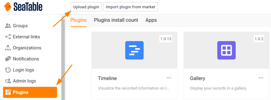

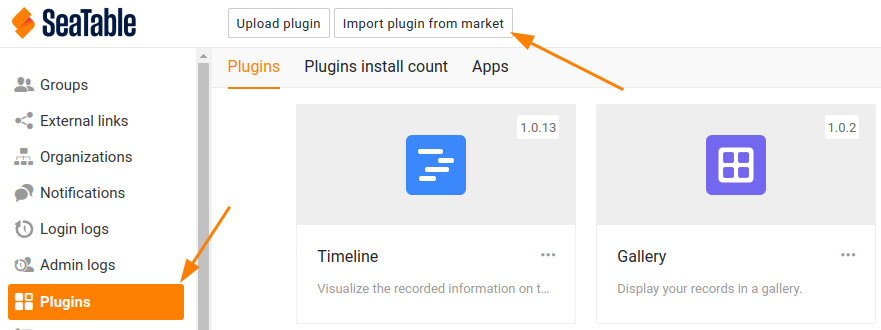

Option 1: Installation/Update via Web Interface
Navigate to the system administration area and select Plugins from the left navigation bar. Click on Import plugin from market and choose the desired plugin. Please ensure that your SeaTable Server has internet access and can download zip files from https://market.seatable.io.
Install Plugins from SeaTable Market
After a few moments, the plugin will appear in the list of installed plugins. Subsequently, all users can activate the plugins in any base.

Option 2: Upload via ZIP-File
If your server lacks internet connectivity, you can still install Plugins by downloading them as ZIP files to your local PC and subsequently uploading them to the SeaTable Server.
The complete plugin archive can be found at the following URL: https://cloud.seatable.io/apps/custom/plugin-archive/.
Upload Plugins manually
After a brief moment, the plugin will appear in the list of installed plugins, allowing all users to activate it in any base.
To update a plugin, simply upload the latest version as a zip file. SeaTable will automatically detect the newer version and update the plugin accordingly.

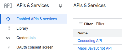

The Map plugin works exclusively with the Google Maps Platform. To enable it, you need two Google API keys, each with different permissions:
  • Geocoding API
  • Maps Javascript API

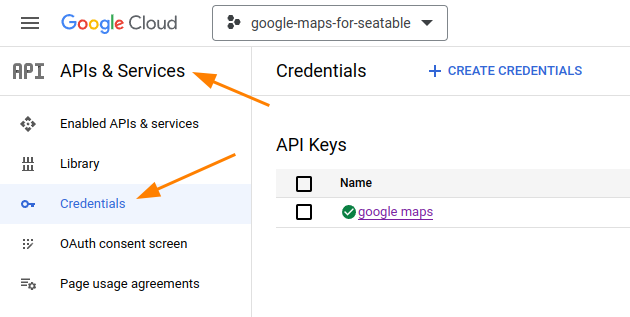

Create two API keys for Google Maps
Required scope of the API keys

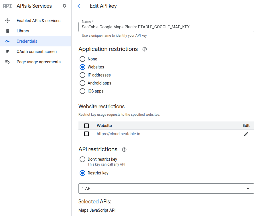

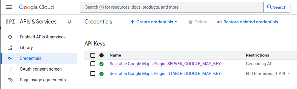

To safeguard your Google API Keys from abuse, restrict their usage. However, even with restrictions in place, abuse remains a risk—especially since DTABLE_GOOGLE_MAP_KEY must be included in your source code and is therefore publicly accessible.
Additionally, heavy use of the maps plugin may increase your Google billing, so monitor your spending closely.
Key Application restriction API restriction
DTABLE_GOOGLE_MAP_KEY Restrict to your Server URL,
like https://cloud.seatable.io
Maps Javascript API

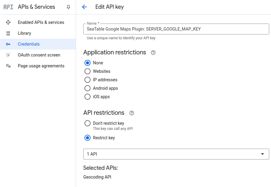

SERVER_GOOGLE_MAP_KEY No website restriction Geocoding API
  • Used for server-side requests (Geocoding API).
  • Do not restrict it to a website (since requests originate from the server).
  • Restrict it instead by API usage → only allow the Geocoding API.
Permissions for SERVER_GOOGLE_MAP_KEY
  • Used for client-side requests (Maps JavaScript API).
  • This key must be embedded in the frontend and will therefore be publicly visible.
  • Restrict it to your SeaTable server’s domain (HTTP referrers).
  • Allow usage only for the Maps JavaScript API.
Permissions for DTABLE_GOOGLE_MAP_KEY
