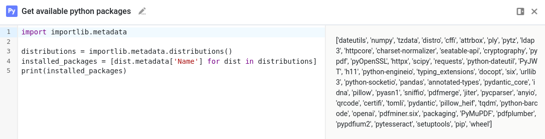

Step 4: Verify Installed Packages¶
Run this Python script within SeaTable to confirm that your required packages are available:
import importlib.metadata
distributions = importlib.metadata.distributions()
installed_packages = [dist.metadata['Name'] for dist in distributions]
print(installed_packages)
This script will display a list of installed Python packages.
