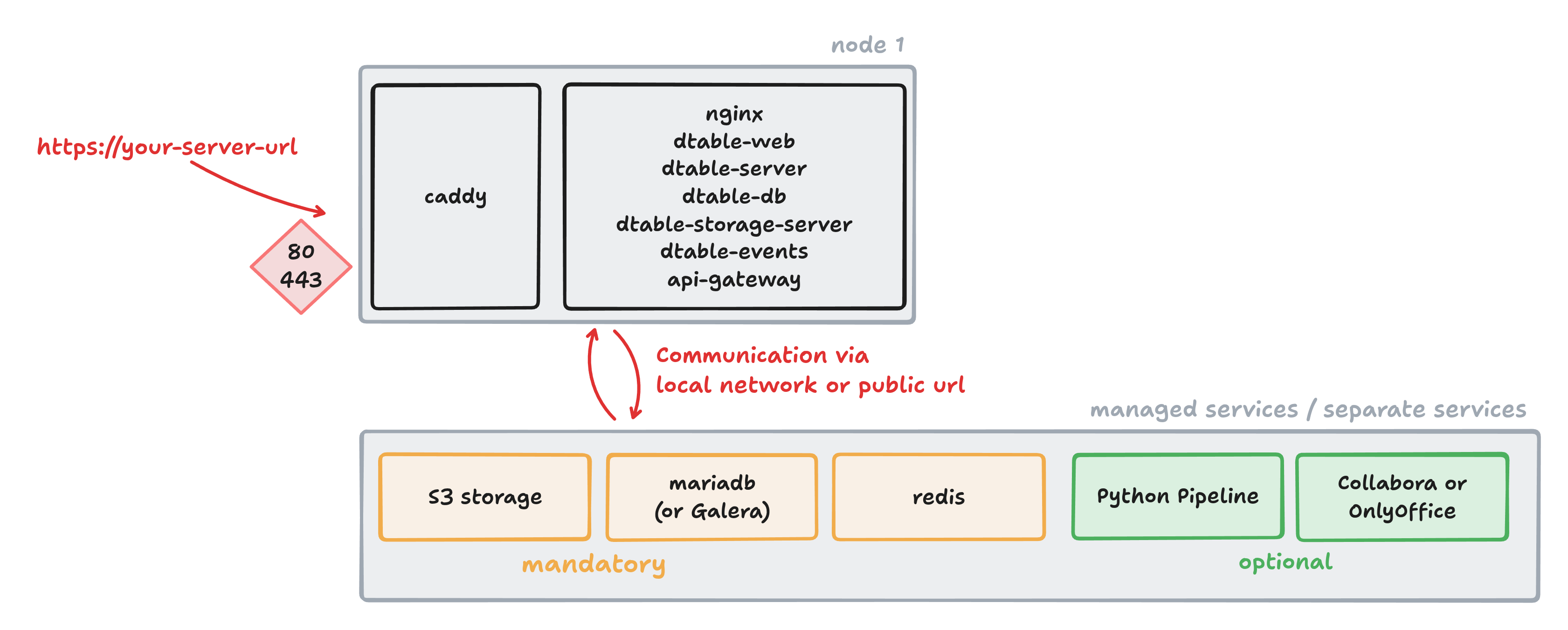

Every SeaTable Cluster installation starts with the deployment of a single node. The main difference is that, from the beginning, you use external services instead of running Redis and MariaDB on the same machine as SeaTable. Afterwards we will move component after component to other nodes.
SeaTable Cluster: Basic Setup
Basic setup with external services
Follow the installation instructions for a single node up to the point where you would start your SeaTable Server for the first time. Before starting the server, you need to make some additional changes to your setup.
Use external services instead of local MariaDB and Redis
Update your .env file to include the required variables for REDIS and MARIADB. Set passwords, IPs, and usernames according to your environment. This ensures that your SeaTable Server connects to these external services.

Now, you can run docker compose up -d for the first time.
After starting, verify that only these two Docker containers are running on the SeaTable node:
  • caddy
  • seatable-server
Log in with your defined admin credentials for the first time to check, that the deployment was successful.
