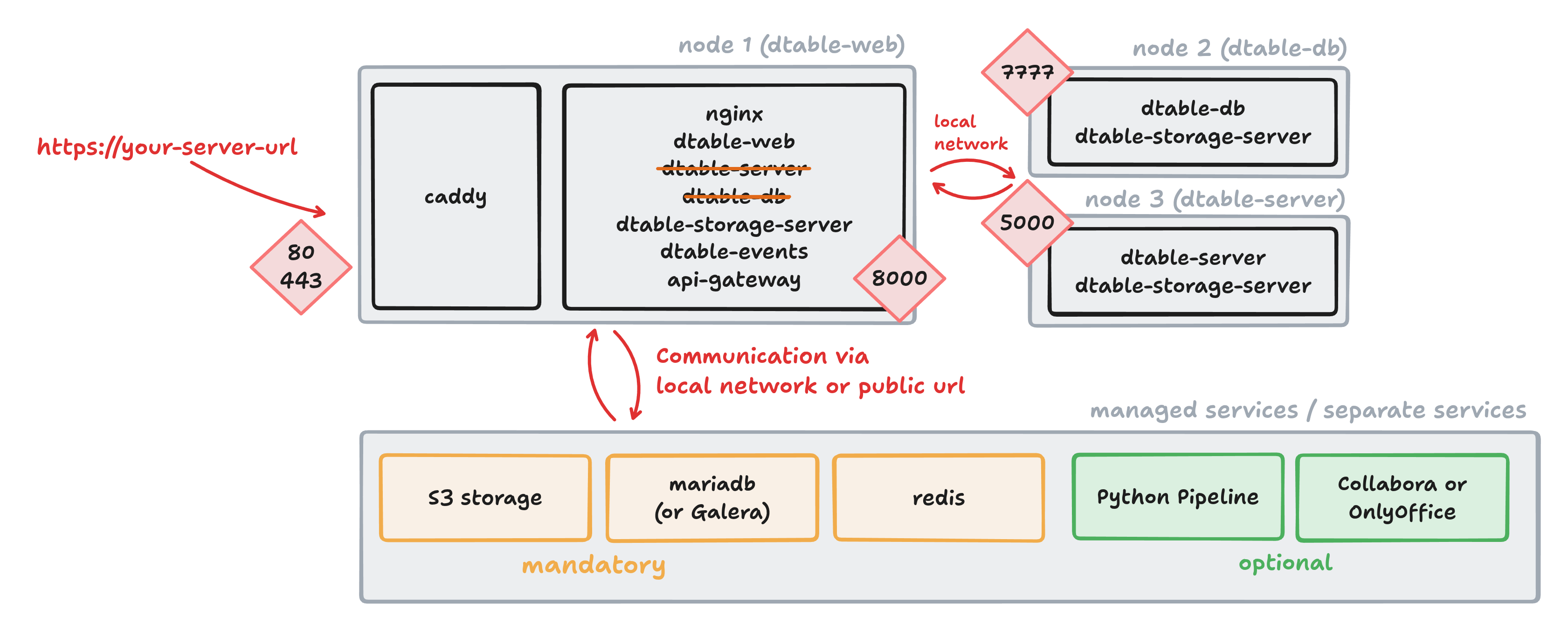

The next step in building your SeaTable cluster is to move the dtable-server to a separate node.
SeaTable Cluster: dtable-server standalone
Setting up a standalone dtable-server

Node-to-node communication uses the internal network. Ensure all nodes can reach each other by adding their names and private IP addresses:
extra_hosts:
  - "dtable-web:10.0.0.2"
  - "dtable-db:10.0.0.3"
  - "dtable-server:10.0.0.4"

Configure dtable-web to use the standalone dtable-server
Now that dtable-server is running on a separate node, update dtable-web to use this node instead of the internal component.
