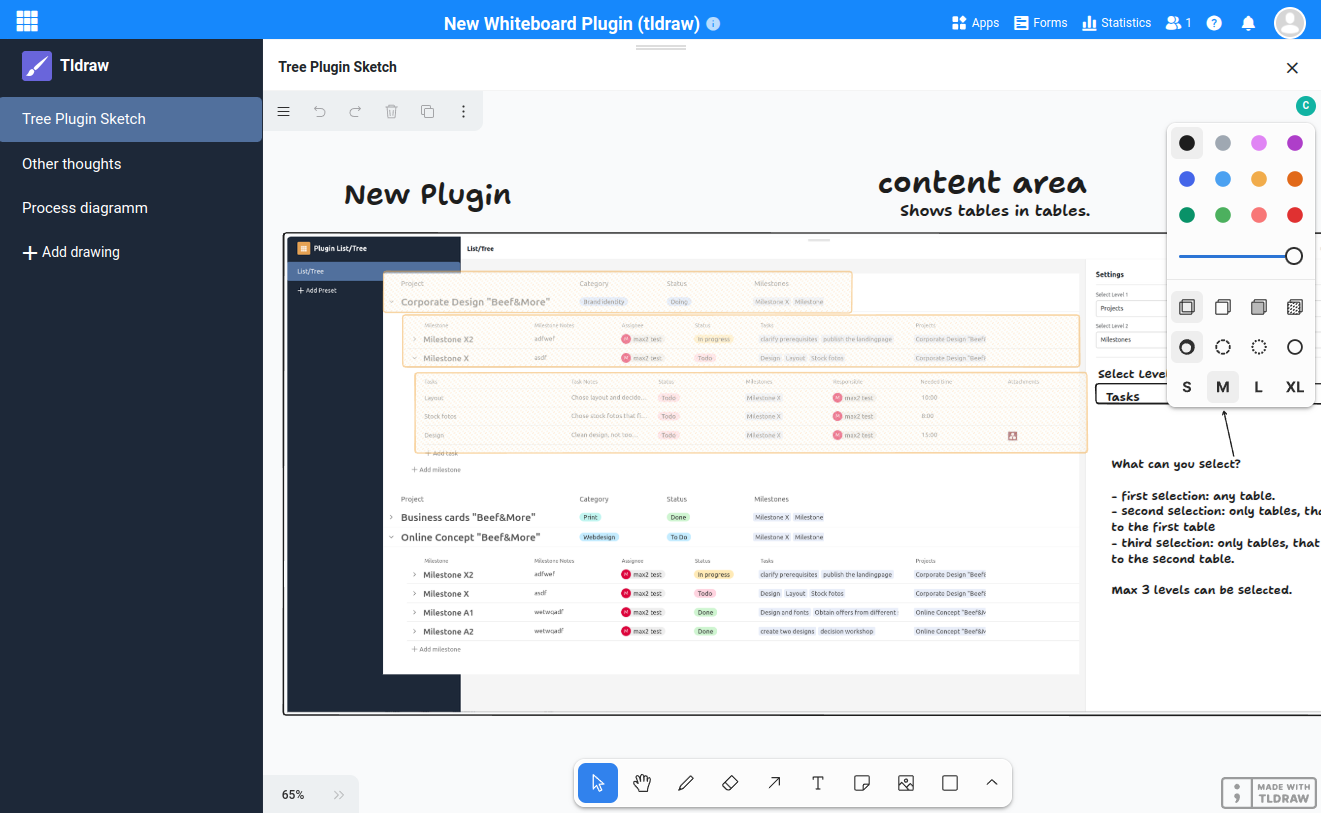

SeaTable's whiteboard plugin offers a versatile platform for capturing thoughts and data, independent of base data. This plugin utilizes the tldraw SDK and requires special installation steps, including server-side components for collaborative drawing.
Whiteboard Plugin
